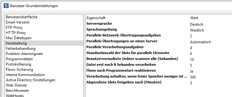

Sorry, here is the value for Concurrent processing (4). I post a screenshot of the complete settings.
Sorry for being in german. I hope you will understand. :?
I wonder why lots of values differ from the defaults in the manual. For example "Release acquired slots after (minutes). Default should be 20 minutes, in our settings value is 5 minutes. I have never changed this setting.
Phoenix Contact GmbH & Co. KG
www.phoenixcontact.com

The important settings for performance are:
Concurrent processing tasks
If you don't have a performance module, then you can set this maximally to 4. This is the case for you, so this is correct. This setting sets how many (heavy) tasks over all of Switch will run simultaneously.
Default number of slots for concurrent elements.
Using this setting you can set a limit to how many tasks each specific instance of a flow element in a flow has. You have this set to 0, which means there is no limit for for specific instances of flow elements, only the global limit set by the "Concurrent processing tasks" setting.
When you change the setting Jan referred to via Advanced Performance tuning on a specific element, then you overwrite the "Default number of slots for concurrent elements" setting for that specific element.
When you do the test in PitStop Server standaline, can you open the progress view (menu progress, show progress)? There you should see the active jobs. How many active jobs do you see at the same time?
PitStop Server standalone has no limit in the amount of concurrent jobs. Switch has a limit depending on your licenses.If you don't have a performance module, then the limit is 4.
If PitStop Server standalone is doing 6 tasks at the same time, then it will naturally be faster then PitStop Server via Switch with a limit of 4.
