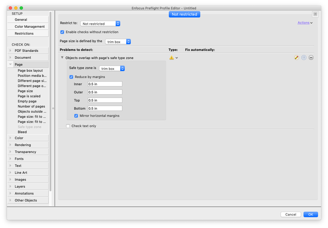

I'm looking for a simple preflight profile to check to make sure there is nothing in the margins (.5"). Does anyone have something like that?

This is the option you need in the preflight profile Nick
Screen Shot 2020-04-03 at 4.57.51 PM.png (137 KiB) Viewed 5194 times
This is the easiest way, for more control there's an Action 'Check Page Safe Type Zone'
That can be combined with other selections and actions.

Thank You, I was having the hardest time trying to get that to work... I didn't have "Reduce by margins" checked.
