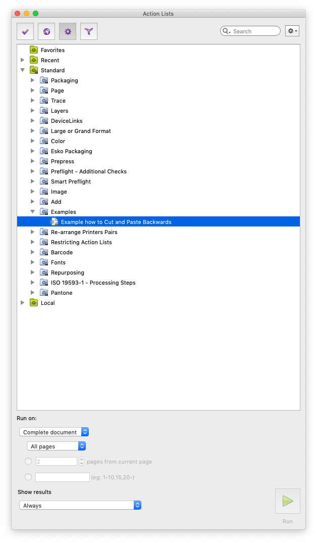

There is an example in the standard action lists that might be useful for you (below)

- download.jpg (32.74 KiB) Viewed 9996 times

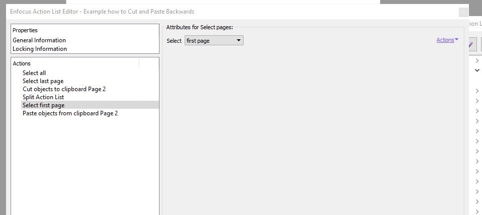

Re: Move Object Between Pages
When attempting what is shown in the example action, it collects all of the objects and pastes all of them on page 1.

Ok. two issues.
First one. It's selecting all the objects as there is a 'Select all'. You need to find a selection or selections that will will do what you want.

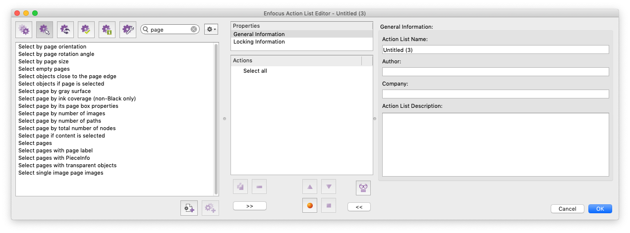

There are a lot of different selections available and you can combine them.
Second one. previous page.
Not sure what you mean by previous, but there are also various ways to select the page you want to paste the object(s) to.
'Select page if content is selected' might be a useful one.
