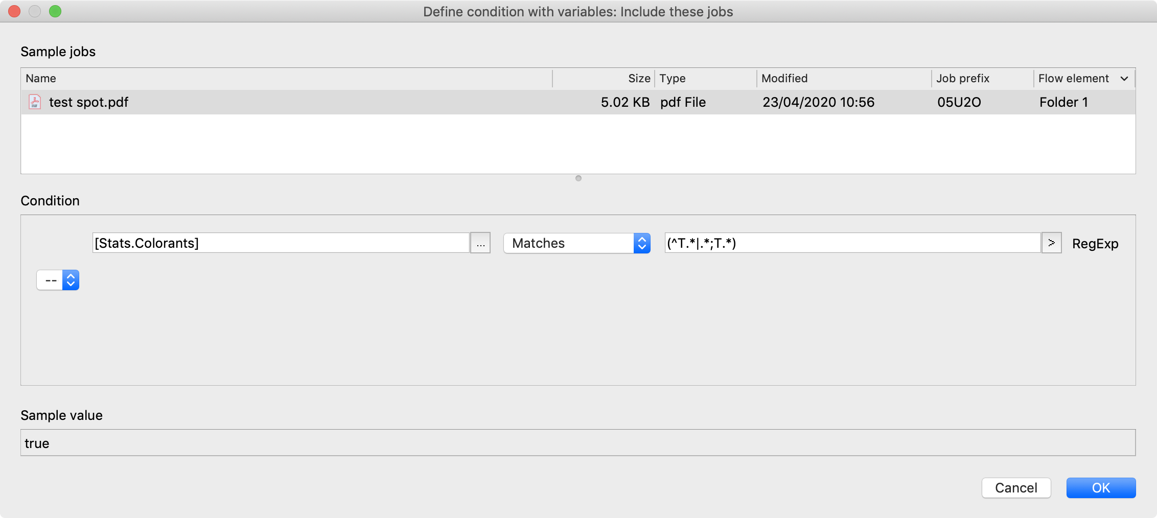

You can catch both of these with a regular expression:
^T.* => If it matches this, then the complete Stats.Colorants string starts with a T (^ stands for start of string, T is used litterally and .* means any character repeated 0 or more times)
.*;T.* => If it matches this, then there is a ";T" somewhere in the colorants string. ( it is ;T with before and after it any character repeated 0 or more times
(^T.*|.*;T.*) => If it matches this, then either the colorants start with T or it contains a ;T (It is the combination of the previous two regular expressions)
So if you setup a condition where:
[Stats.Colorants] matches (^T.*|.*;T.*)
Screenshot 2020-04-23 at 11.07.41.png (144.18 KiB) Viewed 4709 times
Then you should be able to sort out any PDF with a spot starting with T. For any spot starting with M this becomes:
[Stats.Colorants] matches (^M.*|.*;M.*)
