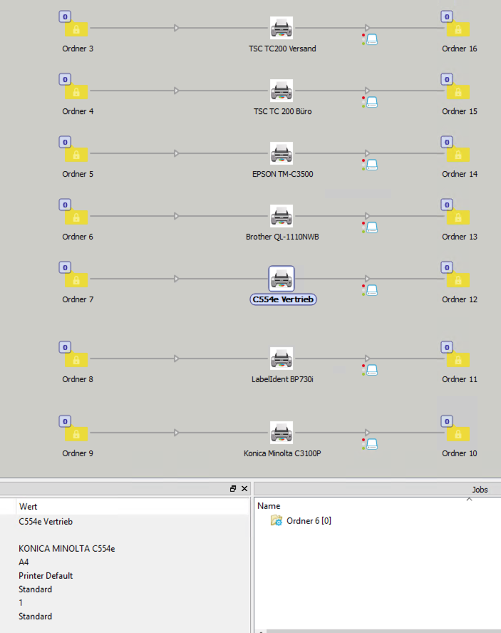

Hey there,
I am currently testing the PDFPrinter APP we found at the Enfocus Appstore.
The goal is to send incoming files to network printers. Office and Label printers.
The Flow with the app looks like this:
Bildschirmfoto 2020-07-08 um 13.29.00.png (154.02 KiB) Viewed 21453 times
For some printers it works very well for some not, Switch brings up an Error Message that some ScriptExecuter....exe crashed.
Is there any other solution for this use-case.

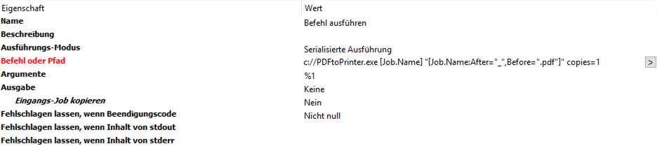

I also found a similar tool to ghostgum its called pdftoprinter http://www.columbia.edu/~em36/pdftoprinter.html.
Sending print jobs to a printer via cmd is easy, there is no pdfreader poping up now its completely silent.
But its also possible to define the amount of copies to print, the printer and the file as variables. But how can I build this in execute command?
My files are named like YB27_bkromer_copies_2_BP730i.pdf and the command should look like
c://pdftoprinter.exe c://hotfolder/input/YB27_bkromer_copies_2_BP730i.pdf  "BP730i" copies=2
So I need the variable [Job.Name:After="copies_",Before="_"] for the amount of copies, the [Job.Name:After="_",Before=".pdf"] for the printer name and the [Job.Name] for the pdf file to print.
Is there a way to make this work?

You could probably do it with a .BAT or Shellscript file. Use the App Execute Command Friend to create such a file and then let Execute Command run it. With that app you could build up your command with Switch variables.
