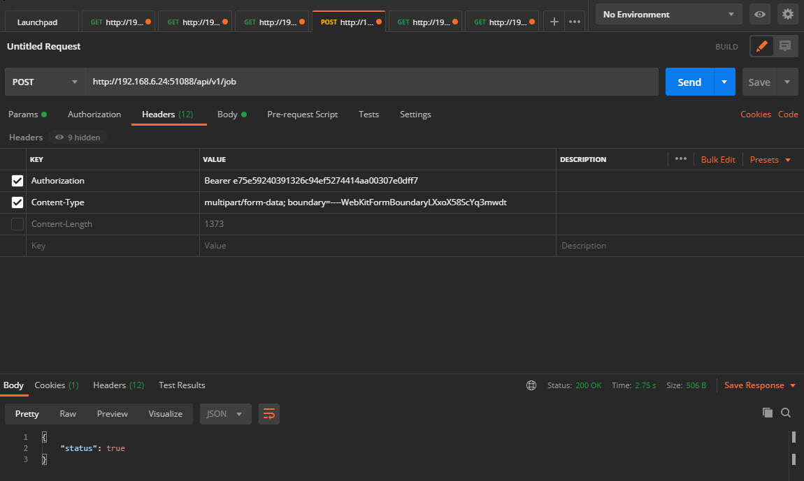

Good evening!
Trying to run the job using PHP and REST APIs.
If you run the task through Postman, everything works out.
And if you throw cURL into the terminal, then he also works it out.
Here are the screens with Postman.
But if you insert code with cURL in PHP, formed in Postman, then nothing happens.
Sample code.

It is easier to go a more "modern" route.
Let the upload PHP-page store the file on its webserver and in the same time you upload an XML to a Switch Webhook. This is read in the flow and in the next step you get an XML to a Switch HTTP Request that downloads the file to the flow. It is much more quicker since the RestAPI require you to encode the upload in Base64 which take time and resources on both ends.
