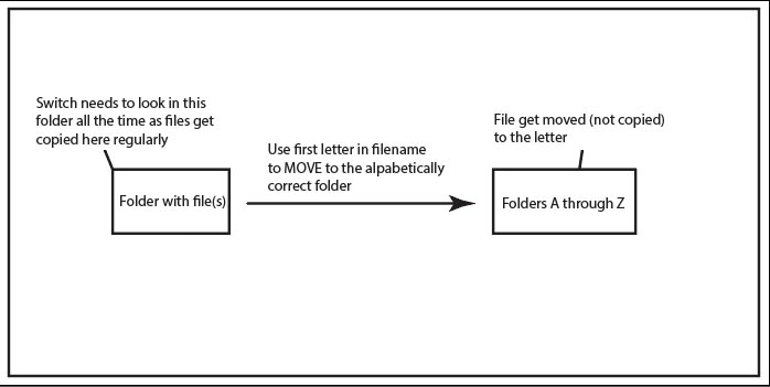

I need Switch to "Look" in an existing folder (this is where the file(s) I want to move reside) and by using the first letter in the filename, MOVE (not copy) that file to a new folder (which is a list of folders from A to Z). So I will need Switch to constantly "look" in the folder and then when a new file appears, to MOVE that file to the appropriate letter folder (A-Z). Note that the file folder are all within the same parent folder.

Doesn't my suggestion work? In my screenshot I had an automanaged folder as the input folder, but naturally it would be a user-specified one, i.e. the folder which gets updated with new files over time. And yes, they will be moved, not copied to the output folder in the A..Z folders. Can you clarify what part doesn't work?

Yes it worked. Thank you very much! In looking at the individual modules I can't see how it knows to move into the appropriate Letter folder. Where does it say to "move to folder A". Just want to understand where in the Flow it says to do that. Thank you!
