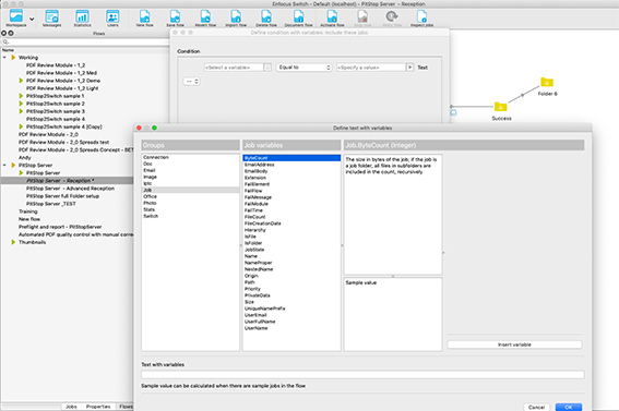

Firstly understand that this functionality is not in PitStop Server itself, it is in Switch Core which now ships with PitStop Server.
We are in a transition to make PitStop Server Switch based, so a lot of new workflow and variable functionality is now available.
With the Switch aspect you can define workflows, and part of this is file routing.
You have the ability to route on various things such as file name, and file type, but also on the characteristics of files.
In this case we are going to use the file size, so you would have two routes in the workflow, one for files -10mb, one for files +10mb.
Below is a screenshot of the variable you need for routing on the file size.
If you look at the documentation, you would need to route on 'Define Condition with Variables'.
