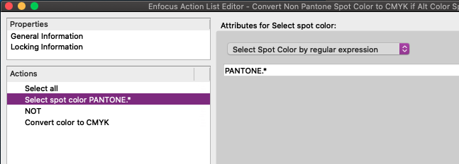

Re: Random Spot Colors - Convert to CMYK
Thanks for the information Ben!
I noticed that I have accidentally created an Pantone Color with Lab as Alternate color space, that's why it worked as intended..
It's been a while since I did that flow and it was only for testing purposes.
This works as intended:
