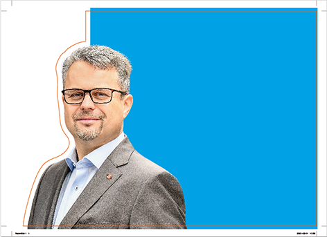

Hi, I'm trying out the 'Make trace path' feature in Pitstop Pro. I almost get the results I'm looking for, but I want the created path to be cropped/substracted by the trimbox of the PDF.
This is the result im getting:

Hi Magnus
I think the attached does what you want?
You just need to sort out the overprint as I did not do that.

Thanks a lot Andrew, your action works exactly as I intended!
