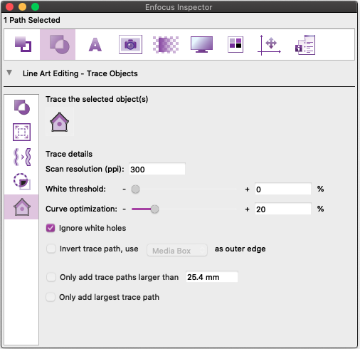

Re: A way to convert line fill to 1 line
If you have PitStop 2020 or later you could use the Trace Objects (found under Line Art Editing) to create a new path.
The new path will trace along the outside of the line fill, so the difference in size shouldn't be that big.
Check Ingore white holes to only get a single path.
Make a copy of the original pdf and remove everything except for the cutting path.
Trace the object and then copy/paste the new path to the original pdf.
- Skärmavbild 2021-04-23 kl. 14.19.31.png (65.25 KiB) Viewed 9010 times
