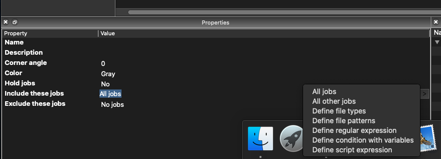

you should be able to change the property of the connector under "include these jobs" to define which files should pass to InDesign.
you can chose based on file type, pattern, expression, condition with variable, or by script expression.

Switch recognizes Indesign packages as such, so you can simply filter job folders on the file type Indesign.

Thank you both for your assistance. Stupid me, didn't realize how the file filters work. Now I know – if a folder contains an InDesign file on level 1, it will qualify and pass on. I will look into the Folder app you mention.
