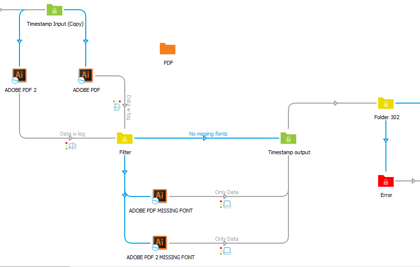

I use Illustrator files that sometimes have fonts that are not available on my Switch.
I want the Illustrator element to give out(and log into metadata) a warning of the missing fonts but still successfully process the file via a custom script.
A few problems arise with this:
1. The illustrator element has no "Warning" level outgoing connections
2. The only option with unavailable fonts is to Fail the jobs.
Since i have no access to the Illustrator elements script package, i cannot edit it to have a warning level connection.
Maybe one solution would be to log the missing fonts to the AdobeConfiguratorLog metadata and not Fail the job. But i am not sure how could i accomplish this.
Another option is maybe to log the missing fonts to any external dataset, but i am not sure if this is doable via a script.
Can anyone help me wtih this, or give any tips where could i start?

Thanks! The solution i came up with is a little different. It works, but i am not sure if this is the best way. Not sure why should I separate log from the AI file as you described.
First 2 Illustrator elements have "Fail jobs with unavailable fonts" set to "Yes". Both outgoing connections are set to Carry data + log.
Filter is used to sort files based on if they failed the font check or not. If the fonts do not fail, the illustrator script activates in the first element.
The second illustrator elements have "Fail jobs with unavailable fonts" set to "No". Outgoing connections only carry data. This way the failure log from the first element is not overwritten by Switch but the files are still made. In the error catching stage i can filter out files via Adobe configurator log's "success" and "Fontsfail" properties.

You should not separate the log from the AI file, I just had not thought of the fact that the AI configurator has a "Data with Log" output. That is of course better. Your solution is perfectly fine.
