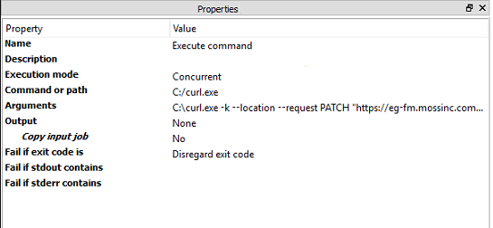

I am having trouble getting my curl commands to go through succesully using the execute command element. Below is the curl and a image of the element settings. Also is there a way to execute a curl command and get a json back using execute command element?
C:\curl.exe -k --location --request PATCH "https://websitename.com/fmi/data/v1/dat ... /records/1" --header "Content-Type: application/json" --header "Authorization: Bearer 9115494870f34db8ba58855895b92e65303eade4defff2c22223" --data-raw "{\"fieldData\": {\"Switch_AutoGLO_InProcess\": "2"}}"

For longer and more complex commands it is recommended to use a .bat file. Place the command in a .bat file and in "Command or path" point to that file.
In order to get the JSON output into a file you must specify an output file and the path to the output file has to come from Switch as a parameter and then you have to tell Switch to continue with that output file:
  • Add --output %1 to the curl command in the .bat file
  • In the "Arguments" property specify: "%2" (the quotes are important to avoid problems with spaces)
  • In the "Output" property choose "File at path" so Switch knows that the command will output a file and not a folder, or nothing, or display some other behavior
Why %1 in the .bat file and %2 in the Arguments? %2 in the Arguments is a variable that will be replaced by Switch by a path to a file (check out the tooltip help for a description of the 3 possibilities). When passing arguments to a .bat file separated by spaces the first argument is %1 inside the .bat file, the second one %2 etc. As the Switch %2 is the first (and only) argument its value is represented by %1 in the .bat file.

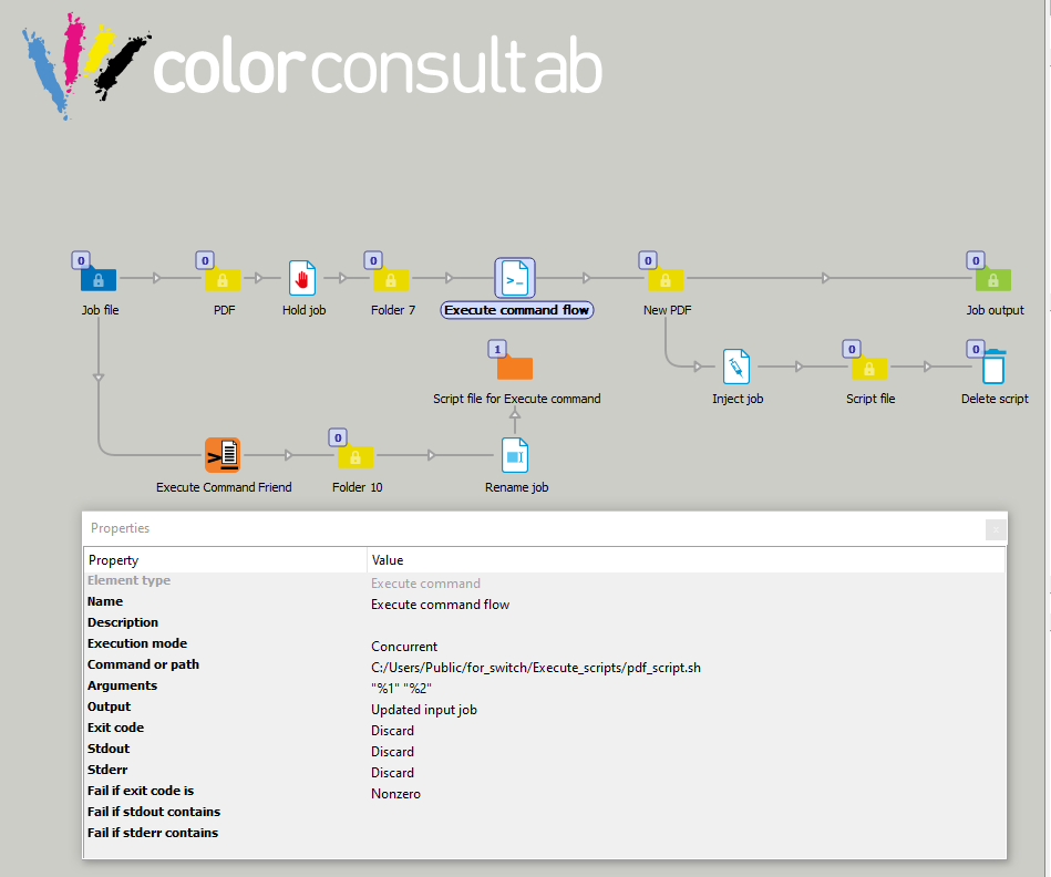

I do need to use variables in the .bat file. Do you have a example of how to set up the execute command to use the output from the command line friend?

The resulting .bat file is used as a command in Execute Command.
See attached flow. You save the .bat file to a folder on disc and Execute Command picks it up from there and run the .bat
In the example I use a .sh file (Shell script)
The Hold Job elements is there for the job to wait for the script file to be generated. It has a delay for 3 seconds.
The Inject Job at the end deletes the .bat file from the folder on disc after execution.
