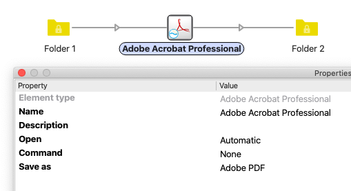

Posts: 1189
Re: Question on Acrobat flow Element
I am not sharing the exported flow because it is too easy to share :D, but here is a screenshot:
Screen Shot 2021-12-16 at 10.02.51.png (34.43 KiB) Viewed 85873 times
That is all I did, of course with the changes to the Acrobat preferences.
Does your input Tiff end up in Problem jobs? What is the error message?

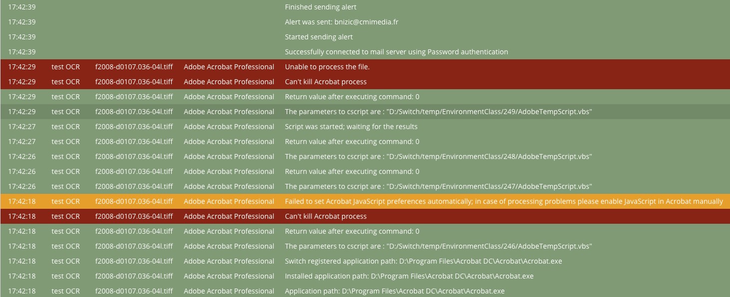

Hi Freddy yes i have an error look my screenshot :
Capture d’écran 2021-12-16 à 17.48.20 - copie 2.jpg (182.98 KiB) Viewed 85848 times
Boris from CMI France
JimmyHartington
Posts: 523
Post by JimmyHartington »
Have you enabled JavaScript in preferences in Acrobat, as one of the log entries says?

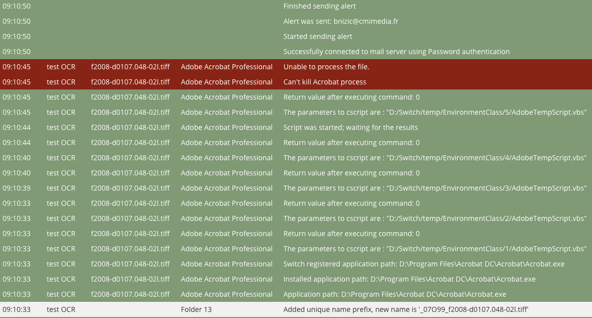

Hi Jimmy, yes Acrobat Javascript is enable... Try again this morning... Error...
