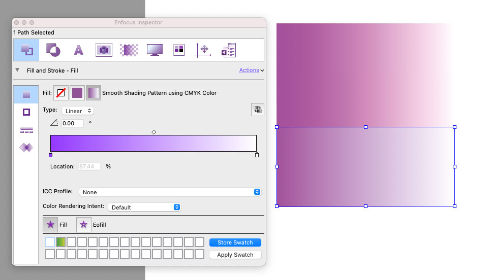

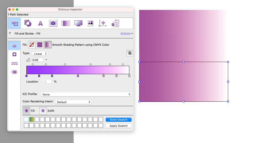

I have one more question related to this. This method worked, however the action caused the gradient to create more nodes than necessary. I have attached 2 images. The "2 NODE GRADIENT" image is what the original looked like and the "GRADIENT WITH 7 NODES" is what it converts to. Is there a workaround for this?
- GRADIENT WITH 7 NODES.JPG (22.35 KiB) Viewed 6538 times
- 2 NODE GRADIENT.JPG (22.65 KiB) Viewed 6539 times

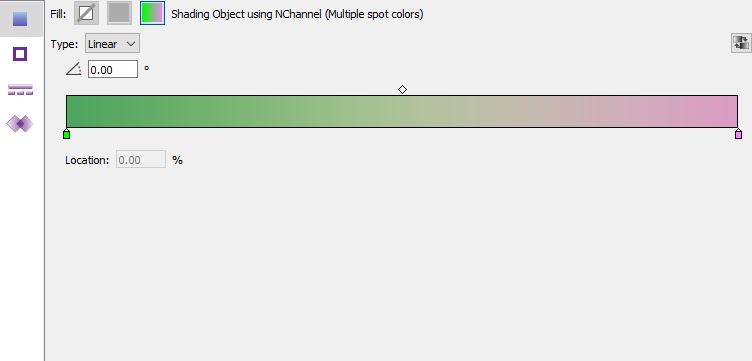

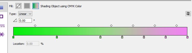

Re: Changing Spot Colors to CMYK in Gradients
Hi wgmeeker,
You can remove those extra stops by dragging them down; I would not recommend this however.
Those extra stops are being added in order to maintain the visual appearance of the gradient. In your example the original gradient has two colours defined: the green at the beginning and pinkish at the end. All the colours in between are calculated mathematically based on those two colours and some gradient function. An important thing to know here is that this calculation is done in the colour space of the defined stops. When converting the stops to a different colour space this can radically change the "in between" colours because doing the same calculations in a different colour spaces gives different results. To prevent this, PitStop adds extra stops to ensure the gradient stays consistent.
There is a simple test you can do to confirm this: take a copy of your original gradient and rasterise it (PitStop Pro menu - Object - Rasterize Selection). Put this image right next to the original gradient, and then colour convert both to CMYK. They should still look the same. Now in the Inspector you can drag the gradient stops down to remove them. What you'll notice is that as you remove stops the shading starts to look a bit different and no longer exactly matches the rasterised version.
