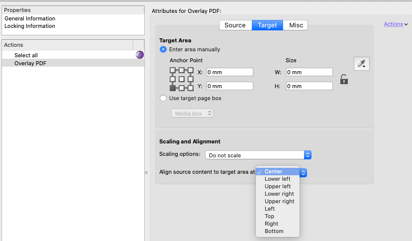

Posts: 1189
Re: Overlay with positioning
The "Overlay PDF" action has positioning capabilities:
Screen Shot 2022-03-09 at 17.31.33.png (59.41 KiB) Viewed 3576 times
Based on your description of the problem, I think that is your solution.
w.bromley
Posts: 37
Joined: Tue Sep 07, 2021 12:09 pm
Post by w.bromley »
Yep thats awesome - thanks very much!
