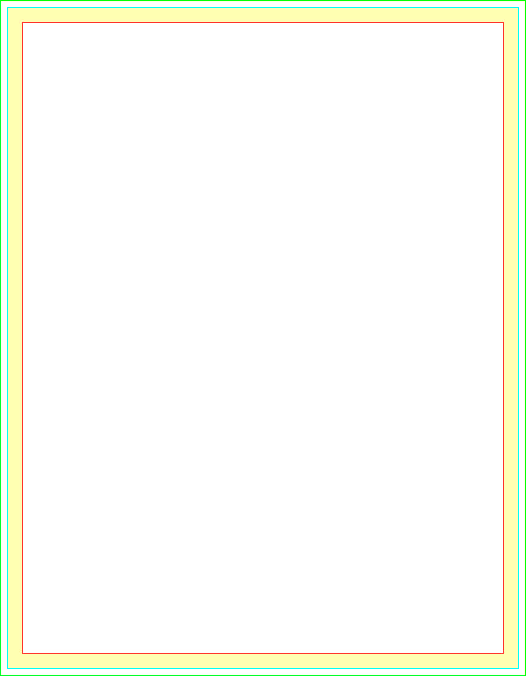

We create files with a Media size of 8.75 x 11.25. Green Lines
Trim size is 8.5 x 11 with a .125 Bleed all around. (8.75 x 11.25) Blue Lines
We set the Art box .25 smaller than Trim Box for our “text safety” area. Red Lines
Is there an action or check to see if there is any text falling in the “safety” region? Between the 8 x 10.5 and 8.5 x 11 region? Yellow
Well actually all I need is if there is any text outside the Art Box. I'm guessing outlined fonts wouldn't be detected nor graphics containing text.
Please see enclosed PDF.
Thank you in advance

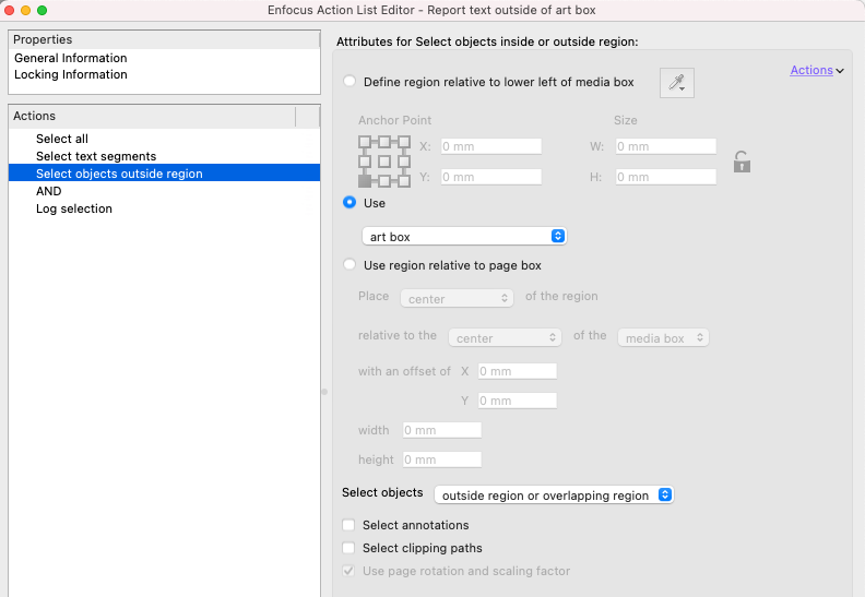

This action list will do what you want:
Select text outside of art box.png (65.77 KiB) Viewed 3576 times
