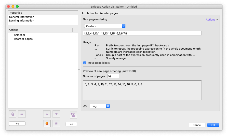

Reorder pages should just put them in the order you define.
Should look like this, and you see the resulting page order below
Screen Shot 2021-10-07 at 5.23.49 PM.png (97.98 KiB) Viewed 4378 times
