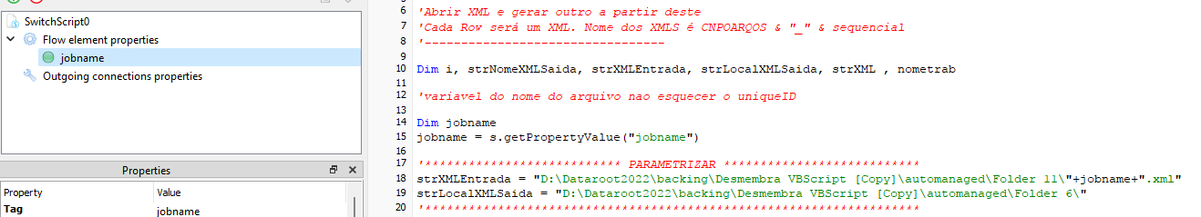

joaodaffonsojr
Posts: 35
Re: VBscript variable to income job
Post by joaodaffonsojr »
Hi !
I found a solution instead converting to javascript.
1st I created a variable in the script to get [Job.NameProper]
2nd I found the Auto_managed folder path for input and output files.
3rd then it was just to put everything in their respective places, and Voilà !
It´s working !
