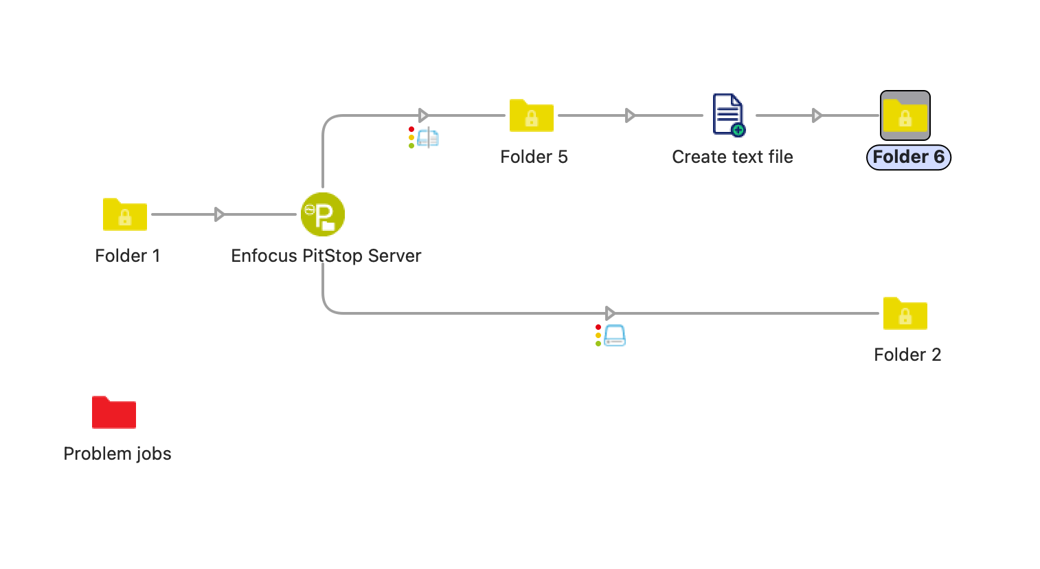

There's an action list element in PitStop called "check barcodes" (or something along those lines, my installation is in German) where you can check for a QR code and its contents. You could then use the free app "Create text file" to get the contents of the QR codes stored in the Log metadata and create a textfile with the barcode information. I've attached a screenshot of the flow. I can send you the flow, just shoot me a message on here with your email
- Bildschirmfoto 2022-04-04 um 11.22.30.png (66.98 KiB) Viewed 25241 times
