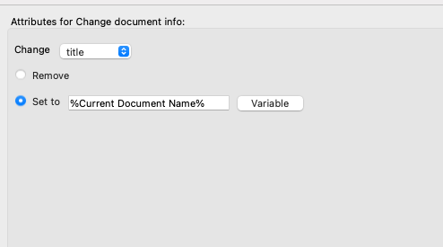

I haven make a action there changes the document titel, in the PDF to the document name.
my issue are a I get the unique prefix remains in the document title from the server, how can I remove the unique prefix from switch.
look like this in pdf
i will not see the unique prefix in the titel in the PDF.

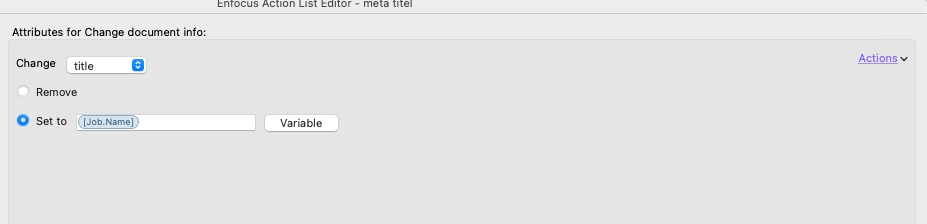

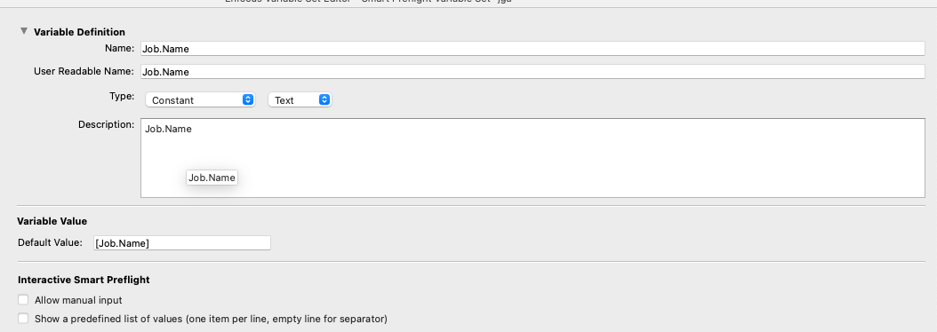

I haven try the PitStop variable, and I can not get it to work, maybe I do it wrong.
I make the variable like this
And inset in the action like this
But in the PDF its are like this
So Its can not see its are a variable. What do I wrong?

[Job.Name] is a Switch variable, is not recognized by PitStop Pro or Server, so using it in an action list will not work.
Create a variable set in PitStop, and define a JobName Text variable.
Use this variable in your action list.
Go to Switch, use the PitStop Server element, select your action list and your variable set, do NOT click on ok, but first right click on the variable set to edit it from Switch, then edit the JobName variable. Use any Switch variable you want, in this case [Job.Name].
[Job.Name] is the job name with the file extension. If you prefer without the file extension, use [Job.NameProper]
