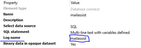

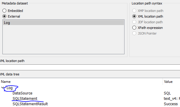

I need more than one SQL selects in one flow. When I put two database connects consecutively, the second override the metadata from the first. Both sql selects are automatically saved into one "LOG" metadata dataset. So how can I save more SQL results into metadata please?
Thanks for advice.
Setting element:
Setting element:
Metadata result
Metadata result

Use the Data with log connection after each SQL query.
Define different dataset names on the outgoing connections.
