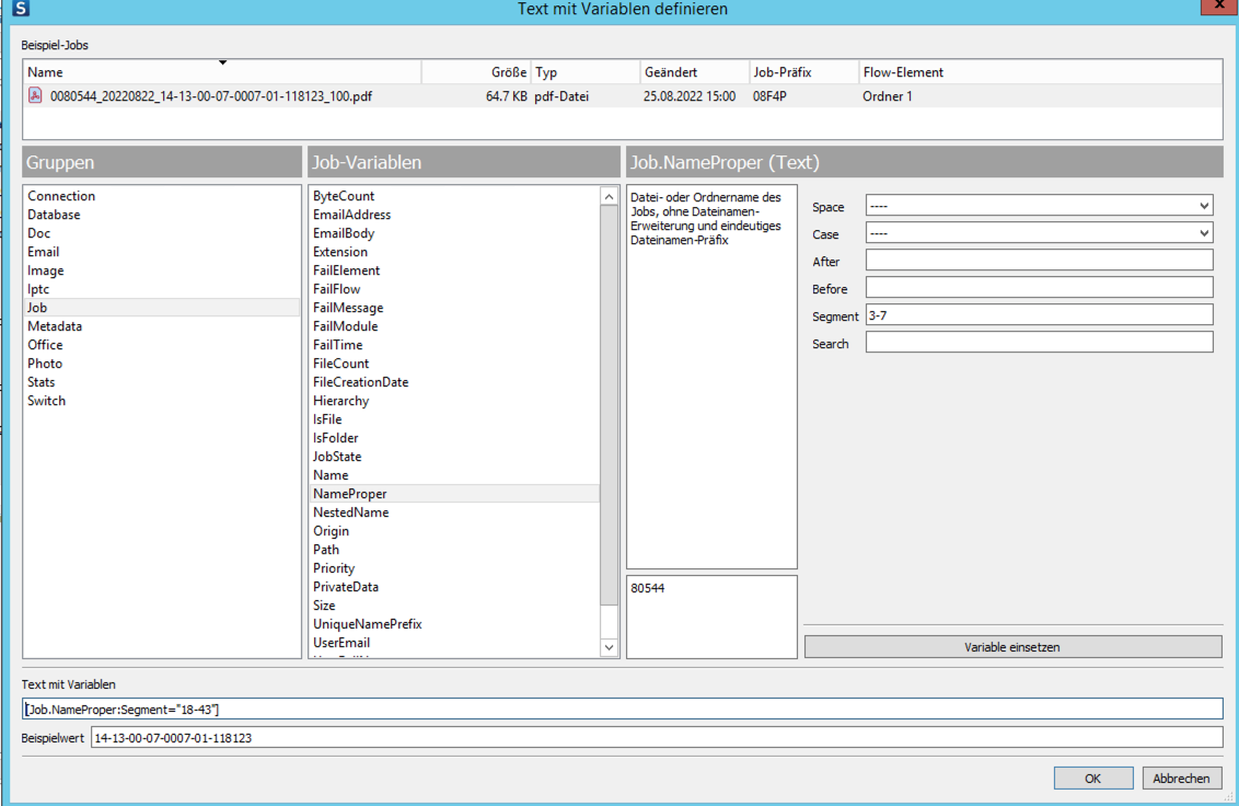

I want to use a segment of the jobname. The challenge I have, is that it's sometimes the character 18-43 but ist could also be 18-46 or 18-40. The charcater string is seperated with underlines. Unfortunately there are more underlines, so using "before" and "after" didn't work. Any idea how i could solve this? I give you an example name and also my configuration of the variable.
Example name 0080536_20220822_12-00-01-07-0011-01-39833_100
the bold characters are the one I would like to use. I hope i found the right words to describe my problem.
Thank you
Bildschirmfoto 2022-08-29 um 16.06.48.png (171.24 KiB) Viewed 10758 times

The StringSplitter app is the right solution.

Perfect, that was exactly the hint I needed, thank you!
