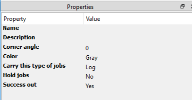

i need to find out if the "Carry this type of jobs" log connection is used, so i can create a log file only when the log is requested.
the properties list of the connection is empty

That is not possible but it is also not really necessary: you can always create a logfile and send it to log. If there is no log connection there will be a warning message, but that is all. And when the user defines "Job with log" the sendToLog result is automatically attached as a dataset.
