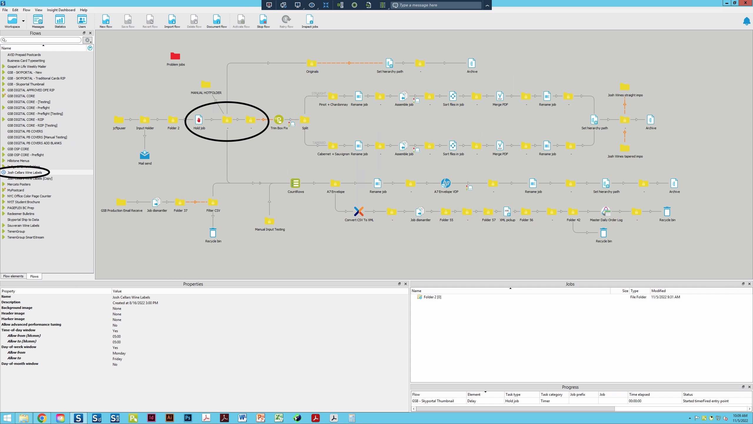

Has anybody ever had a flow that won't activate because, "flow has been scheduled for activation; the flow will become active automatically according to its time window properties"?
The flow won't full activate all of a sudden. Its supposed to pull files in from a FTP as they arrive, and then the hold tool releases them into the flow at 5AM. But now that the flow is not fully activating, nothing is functioning.
This morning at 5AM the files were stuck at the hold tool, which has never happened before. I've been runnig this flow for two weeks now so I'm not sure what changed.
Any idea how to release this "hold" on the flow so that the flow will stay active?

You need to have a few minutes difference in when the flow is active.
