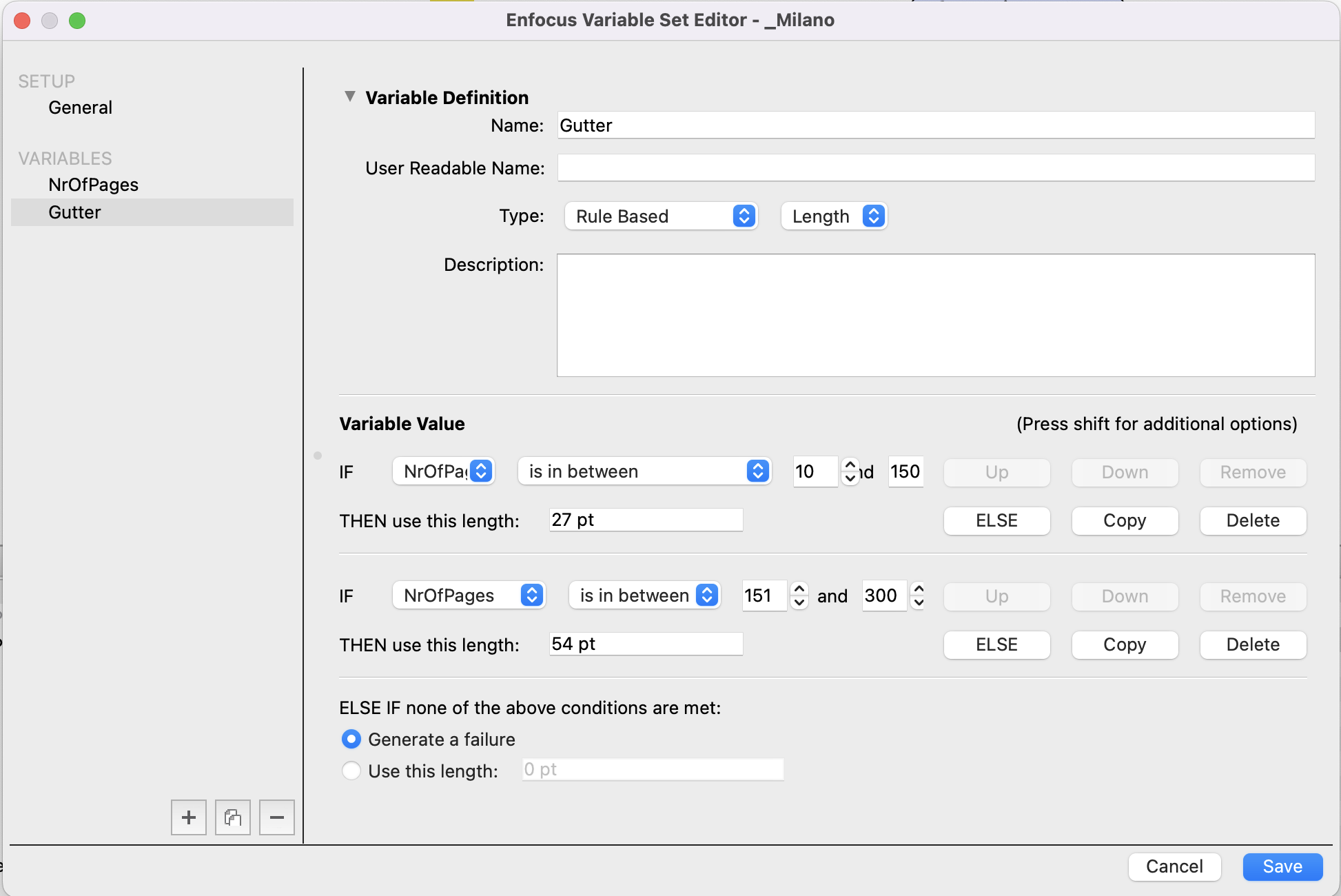

You posted this in the PitStop Pro section of the forum. That is understandable and fine. But it is supposed to be hands-off, so may I assume you have PitStop Server?
In that case in the Variable Set you define a variable "NrOfPages" as a number using the variable [Stats.NumberOfPages], and a "Gutter" variable as a length and as a rule-based variable.
Screen Shot 2023-01-10 at 17.54.54.png (237.31 KiB) Viewed 4299 times
The value is in pt, but when typing the value you can type it as 0.375in and it will get converted. In the Action List or the Preflight Profile you can use the Gutter variable and it will be dynamically adapt to the number of pages.
