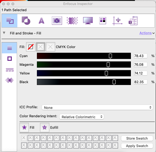

Regardless of what type of file I have open, I am getting the following error messages:
  • Eyedropper tool > click on any object = Could not find ICC profile for RGB
  • Converting any object to CMYK/RGB/Greyscale = Invalid ICC Profile
*All swatches on the fill/stroke tab of Enfocus Inspector show X (see below)
Screenshot 2023-03-07 at 12.58.32 PM.png (49.89 KiB) Viewed 3780 times
Seems like there is some sort of data or profile that is missing. Any thoughts on how to solve this?

Check your Color Managment settings in Pitstop settings. It is possible that the assigned default RGB profile is missing on your computer. Change the default RGB color profile to something that you have installed on your computer or install the missing profile on your computer.
