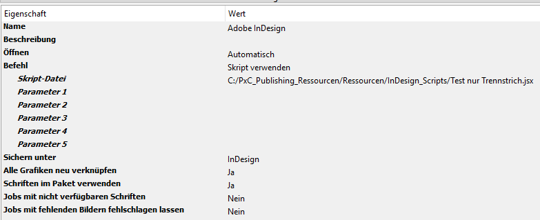

The script works fine as a local script in InDesign. However, when I include the script in the InDesign configurator, it does not work. There is no error message in the switch log, the script is "executed successfully". However, the Find+Replace function has not been executed in the result, all "Discretionary Hyphen" are still there.
Does anyone have an idea what this could be due to?

thanks for your tip, but unfortunately it does not solve the problem. The script is executed by Switch without error message, but unfortunately without executing the Search+Change function.
Unfortunately, I am at a loss here as to what the problem may be, because locally or manually started, the script runs fine and performs the GREP search in InDesign.
