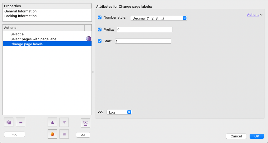

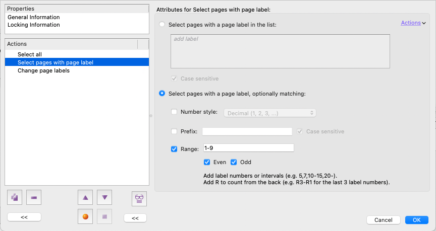

I have a PDF containing 56 pages. I need to change the page labels for the pages 1-9 into 01, 02, 03 etc.
I have made this simple action that (is supposed to) select the page range 1-9 and add the change the page labels by adding 0 as a prefix.
Skærmbillede 2023-03-28 kl. 14.59.24.png (151.73 KiB) Viewed 24666 times
Skærmbillede 2023-03-28 kl. 15.07.14.png (119.19 KiB) Viewed 24666 times
But I can't get this to work. The selection of pages seems to have no effect. If I only do the "Change page labels" it works fine but obviously add a 0 to all page labels.
I have also tried to choose "Select pages with a page label in the list:" and add the numbers 1-9 to the list, but it makes no difference.
Am I missing something, or is this a bug?

I do not understand the problem. If you use [Index] the suffix on all pages is two digits, but it seems to me that that is what you want. What is the reason for wanting to use [Label]?
The reason why your Action List does not work is that you are selecting pages based on their labels, but I am 100% certain that the pages of your input file do not have labels so the pages do not get selected and nothing happens. You should use "Select pages" instead.
