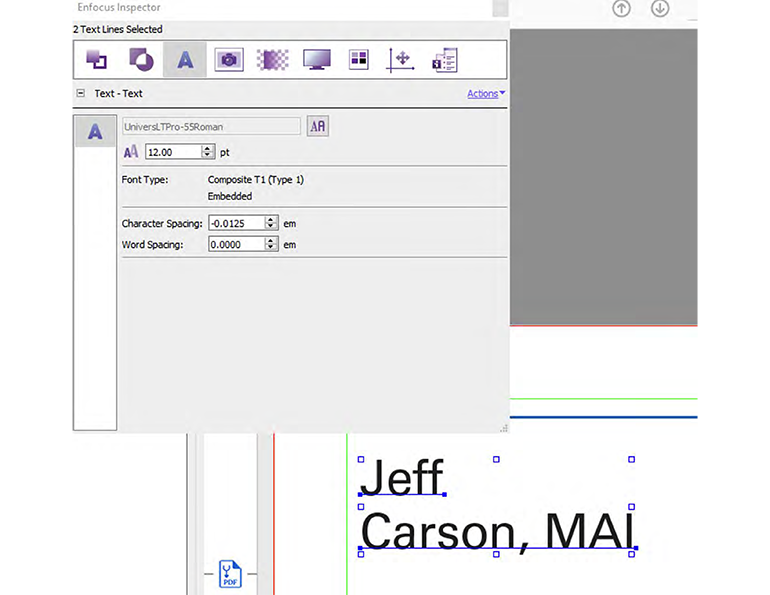

I'm looking to select a string of text in PDFs that are entering a flow, and log that selected string so they are an accessible variable within Switch.
I'm utilizing Switch, Pitstop Server and Pro.
Every attempt I have made in selecting the text segment (which I can do) and logging it, doesn't actually report on the string that was selected, just that an object was selected. The text is a live font. Attached is the text that I'm looking to capture in a sample PDF. I want to be able to use the name on this card, within Switch (i.e., "Jeff Carson")

- Screen Shot 2023-04-18 at 11.52.00 AM.png (231.03 KiB) Viewed 4643 times

Hi
The next PitStop 2023 will bring capacity of logging text properties including contents. This will allow you to achieve your goal.
