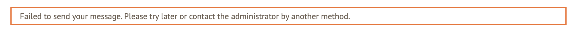

Hi Loic,
I tried to submit but keep getting an error:
