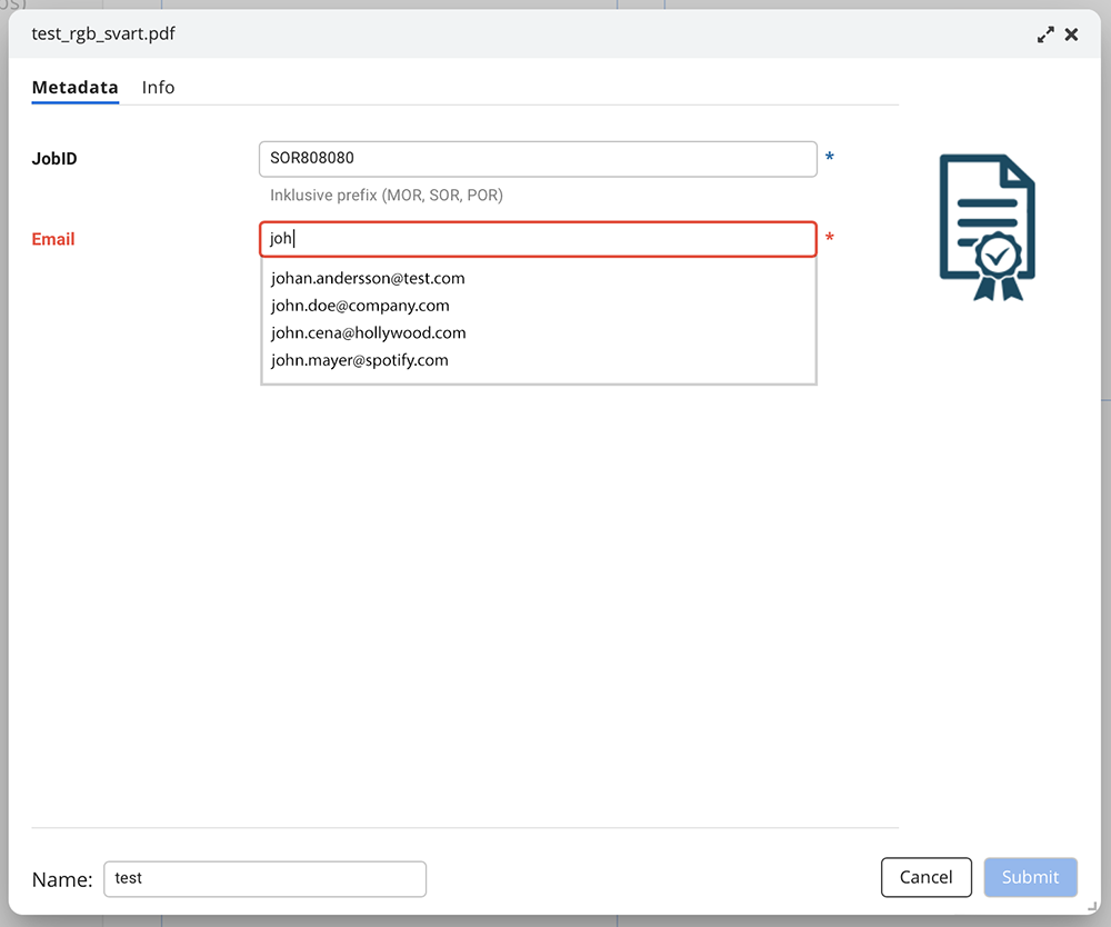

Hi, is it possible to to implement autocomplete in a metadata field in a submit point some how?
In this case I would like to show suggestions of previous used email-addresses when you start typing, like this:

Yes, but if the email address/addresses is not already in the list that approach doesn't work. In my case the user should be able to type any email address. And I would like the autocomplete list to grow when new addresses are added.

Ok, to add another field kinds of ruins the whole idea of a user friendly UI, then you first need to try the drop down field and if nothing comes up you need to fill out another field..
The experience we want to simulate is the one when you are writing a new mail in Outlook and start typing a name in the TO field.
