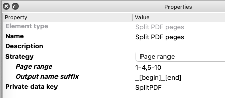

You can write a script to parse the data you provide, and
• duplicate the file as many times as needed
• define the first and last page of each section, and the T1-T2-T3 suffix
Then you can use the Split PDF pages app as illustrated below.
If you provide an XML correctly formatted, no need to script, you can use the Variable XPath Repeater app to repeat the job n times, and define the needed private data.
Split pdf pages.png (26.02 KiB) Viewed 43720 times
