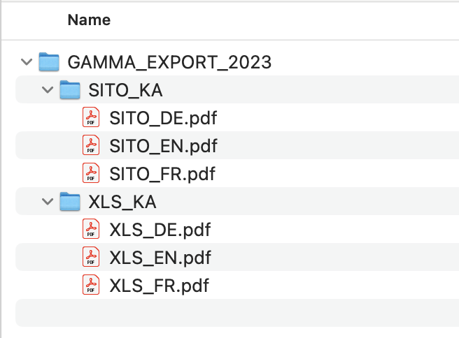

So I have the following folder structure:
HOTFOLDER (known)
- GAMMA_EXPORT_2023 (folder)
- - XLS_KA (folder)
- - SITO_KA (folder)
- XLS__DE.pdf
- XLS__FR.pdf
- XLS__EN.pdf
- SITO__DE.pdf
- SITO__FR.pdf
- SITO__EN.pdf

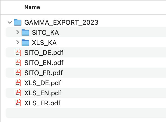

What I am trying to do:
HOTFOLDER (known)
- - XLS_KA (folder)
- - - XLS__DE.pdf
- - - XLS__FR.pdf
- - - XLS__EN.pdf
- - - SITO__DE.pdf
- - - SITO__FR.pdf
- - - SITO__EN.pdf
Bildschirmfoto 2023-10-17 um 09.48.30.png (55.62 KiB) Viewed 11530 times

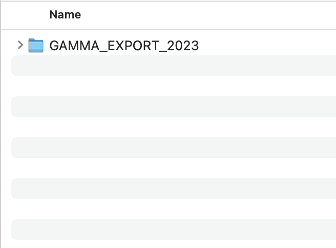

OUTPUTFOLDER (known)
- GAMMA_EXPORT_2023 (Folder)
At the end there should be 1 single folder with all files in it:
Bildschirmfoto 2023-10-17 um 09.52.45.png (22.16 KiB) Viewed 11530 times
If you need more information or sample files then please get in touch. Thanks a lot!

Terkelsen
Posts: 346
Re: Move files by named-pattern into specified folder
Post by Terkelsen »
Use the folder GAMMA_EXPORT_2023 as your Archive hierarchy. In the flow before archiving use the "Set hierarchy path" and define "Path segment 1" as this single line text with variable: [Job.NameProper:Before="_"]_KA
