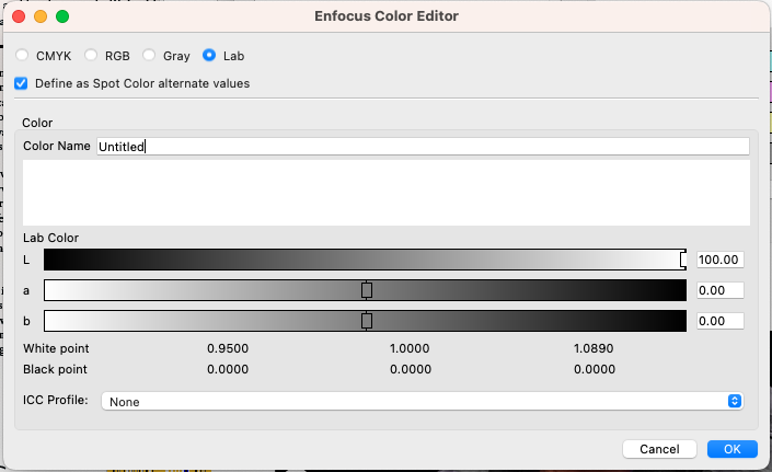

If the spot colors are different you can create your own version of the spot color in the PitStop color database:
Create spot color with Lab alternate color values
Screenshot 2023-10-13 at 10.57.21.png (41.68 KiB) Viewed 11959 times
and use an Action to change the color of the objects using this newly created color.

I'm probably doing it wrong, but if I create a color with the same name/different values, it still sees the first color when I try to swap them (understandable).
I was able to replace with a temporary color. Save, close, re-open and then replace the temporary color with the 'same name/different vales' color, but at that point it's easier just to open the pdf in illustrator and edit it there (not always an option though).
I guess what I was hoping for was that Color Editor view from your screen cap, but for an existing/in use color where I could just plug in new values and save. Maybe in a future release! ;)

You can make it work! Create the spot color in the Color Library. Note that there can be multiple spot colors in the Color Library with the same name and different alternate color values. Use the Action "Remap spot color". In "Spot color to remap" you specify the name of the spot color you want to remap. And you remap to "User swatch". Click on "Load" and from the Color Library choose the correct spot color. Run.

Hmm, could have sworn that's what I did, but I guess not lol! Just tried again and it worked. THANK YOU!!
