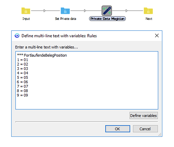

If you don't have the scripting module you could do this:
Set job Private data:
FortlaufendeBelegPosition=[Metadata.Integer:Dataset="Xml",Model="XML",Path="/daten/kopf_und_posten_daten/positionen/position/FortlaufendeBelegPosition"]
Then use the app Private Data Magician to add a leading zero for 1-9:
Now you can use the private data field FortlaufendeBelegPosition and the single digits will have a leading zero.
Maybe not the prettiest solution but it works.
