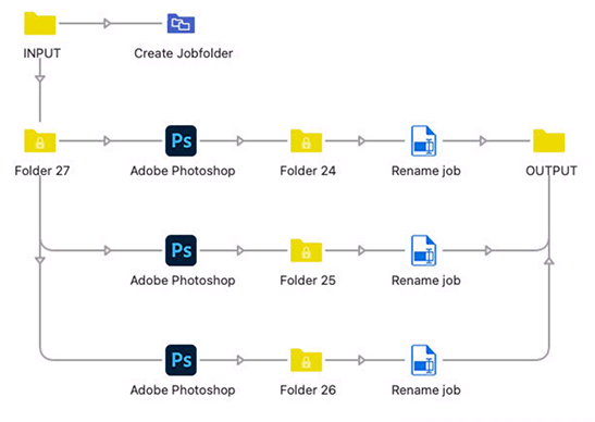

I'm maken a flow to make variations of a image file using photoshop actions.
is used "Create Jobfolder" to create a folder based on the filename.
So the main folder is the filename without the extension (Job.NameProper)
and I have two subfolders made. Let's call them "Sub A" and "Sub B" for an example.
so fat so good, this works.
but...
In the same flow I have 3 photoshop actions running on the original file. At the end of the flow I need those 3 files to be placed in the "Sub B" folder that I created in the same flow.
Is this possible? and how?
I added a printscreen of the current flow so far. But in stead of the output folder i need the files in the created "Sub B" folder.
Thanks in advance.

Re: continu flow in created jobfolder
Placing jobs in subfolders and subsubsubsubfolders requires the use of "Archive hierarchy". Here is learning session that explains how to work with hierachies: https://learning.enfocus.com/course/view.php?id=40
