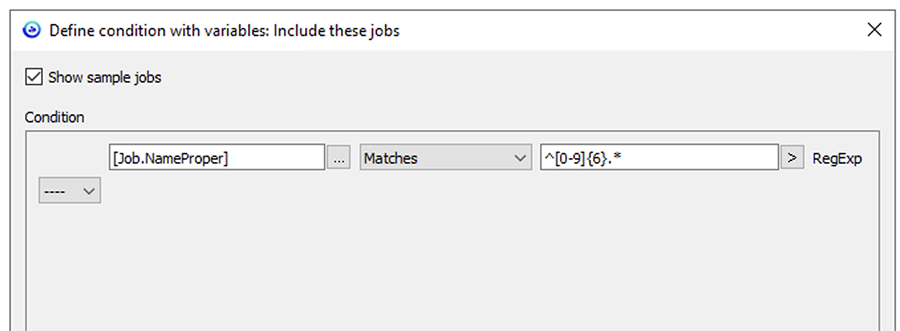

I am trying to make a requirement for incoming files and folder to have a 6 digit job number at the start of the name.
I can get this to work on individual job files, but on job folders it always errors out.
I have included my regx in the attached screenshot. I am not sure what I am doing wrong in the scenario.
Screenshot 2024-02-06 at 9.10.32 AM.jpg (227.03 KiB) Viewed 3946 times

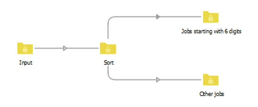

Maybe you can do it like this instead?

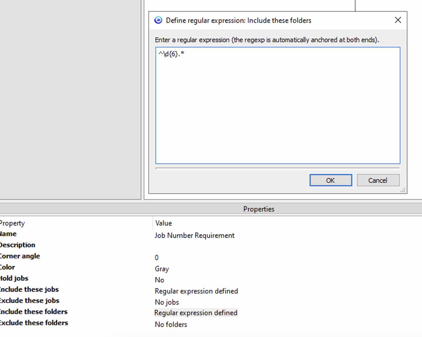

rhd_ole
Posts: 155
Re: Sort Job Folder By Name
Post by rhd_ole »
Have you tried omitting the .* in your expression
^/d{6}
