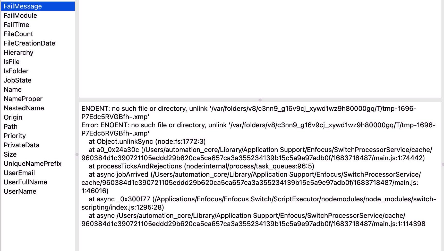

I have an odd error I haven't experienced before. I'm using PitStop Sever to create setup documents for our one presses, and then at times can either go though PS again or in most cases FastLane.
I'm taking a 2 pg pdf and using a variable set to entered by the user to add pages to the document, it's basically adding the variable entered as total blank pages and pasting the first two pages to new range. This works flawlessly.
However if whenever I need to do something else to the file in PS, or in this specific case FastLane ( to grab a few bit of info), it always errors.
Any ideas how to correct or what is actually causing this.

My first thought was that perhaps the file does not contain an XMP section because that is what the error seems to point to, but I tested it and that works correctly.
Please share the settings of the FastLane app and also which version of the app you are using.

freddyp wrote: Wed Feb 07, 2024 1:47 pm My first thought was that perhaps the file does not contain an XMP section because that is what the error seems to point to, but I tested it and that works correctly.

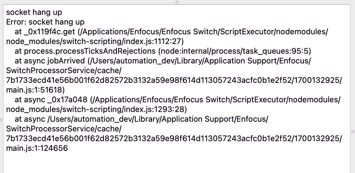

I'm using Switch Fall 22, so I'm using V1 of FastLane. I also will get the socket hang up error from time to time in FastLane, but any files modified by PS always have the first error message I posted.

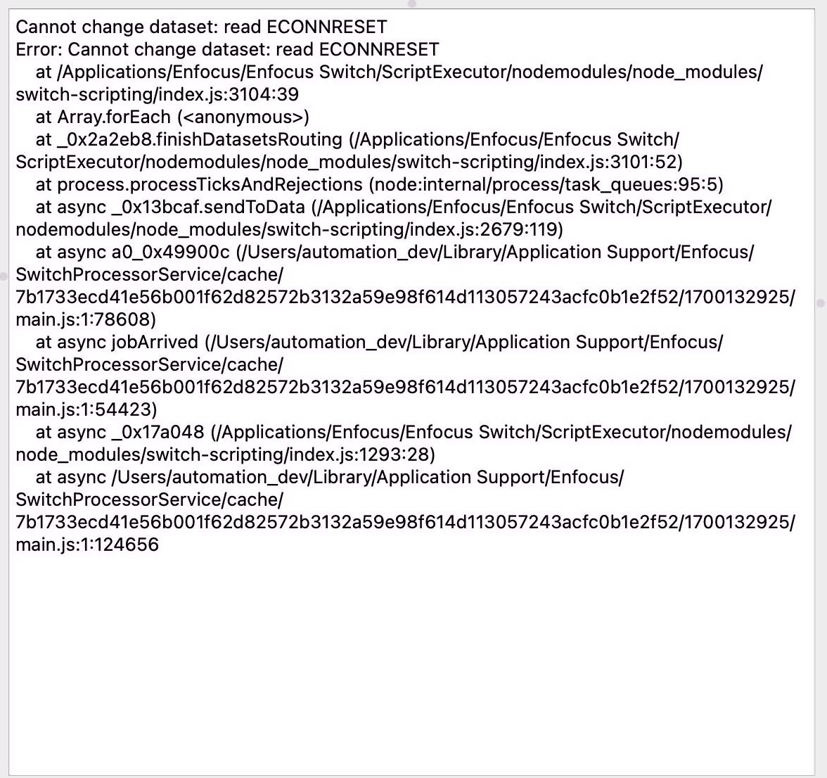

Just tried on Switch 23 Fall and FastLane v2. get the same one error then also get these.
Error3 copy.jpg (203.29 KiB) Viewed 18383 times
Error2 copy.jpg (200.93 KiB) Viewed 18383 times

So quick little update.
I continued to mess with it and I tossed a Pack and Unpack in the flow and it now works on the Switch '22 with FastLane v1.
