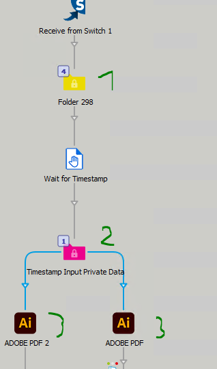

When multiple files are waiting for processing, giving one job the Rush job status does not raise it to the front of the list and still keeps processing jobs in the same queue as they were. See picture for reference. I add rush job to a job in the folder marked 1, so that it would be the first one to be moved to folder marked 2 so that it could be processed in illustrator. But it does not, it still waits in the queue for its turn, even though the other jobs have no rush job status. Is this how rush job is supposed to work, or am i doing something wrong?

If the other files are still "processing" while you hit the rush job, they still need to finish their actual step before leaving place to another one.
Rush job, just allow a max priority to a job.

There is another aspect: the flow starts with Receive from Switch. The Send to Switch and Receive from Switch apps are still written in legacy code and therefore they cannot transfer the Rush setting. I have never tried using rush jobs with the Subflow and/or Flow Links apps, but these are written in NodeJS and with these it may work. Please try and let us know.

I gave the rush job status to the job after it had arrived in the other switch, so maybe this should not affect it? And rather the case is what tdeschampsBluewest described.
