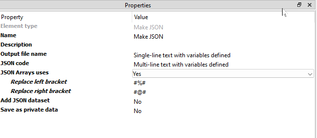

In the latest versions you can use replacement characters to be able to make an JSON array using variables in the code.
Switch uses the Square brackets to define the values from a variable, this conflicts with the JSON array Square brackets and because of that Switch gets confused about the variable values.
So when you define your JSON code in the app all array square brackets has to be replaced with something.
Then when the JSON code is generated Switch will first add the variables and then the proper array square brackets will be put in place. Then the code is parsed to validate it.

the error you got is from parsing the JSON
The Switch variables must be in single quotes for Switch to add the value
"orderReference": "[Metadata.Text:Dataset="Xml",Model="XML",Path="/Job/JobNo"]"
Try it this way, note the single quote around the variable
"orderReference": '[Metadata.Text:Dataset="Xml",Model="XML",Path="/Job/JobNo"]'
Those single quotes will be replaced by the app before parsing and validation.

You still have double quotes around the variables

And I see that you haven't added the replacement characters like "items": #%# and the rest until #@# at the end of that array.
If you rename the app element in your flow with "debug_" at the start your JSON code will show up in the messages Debug section. This can help you sort out what is wrong in your code.
