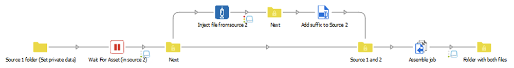

magnussandstrom
Posts: 571
Location: Sweden
Re: Find a PDF with the same name and put both in one folder
Post by magnussandstrom »
Hi, I would build it like this:
Sample flow:
Two files one folder2.zip
(25.98 KiB) Downloaded 953 times
