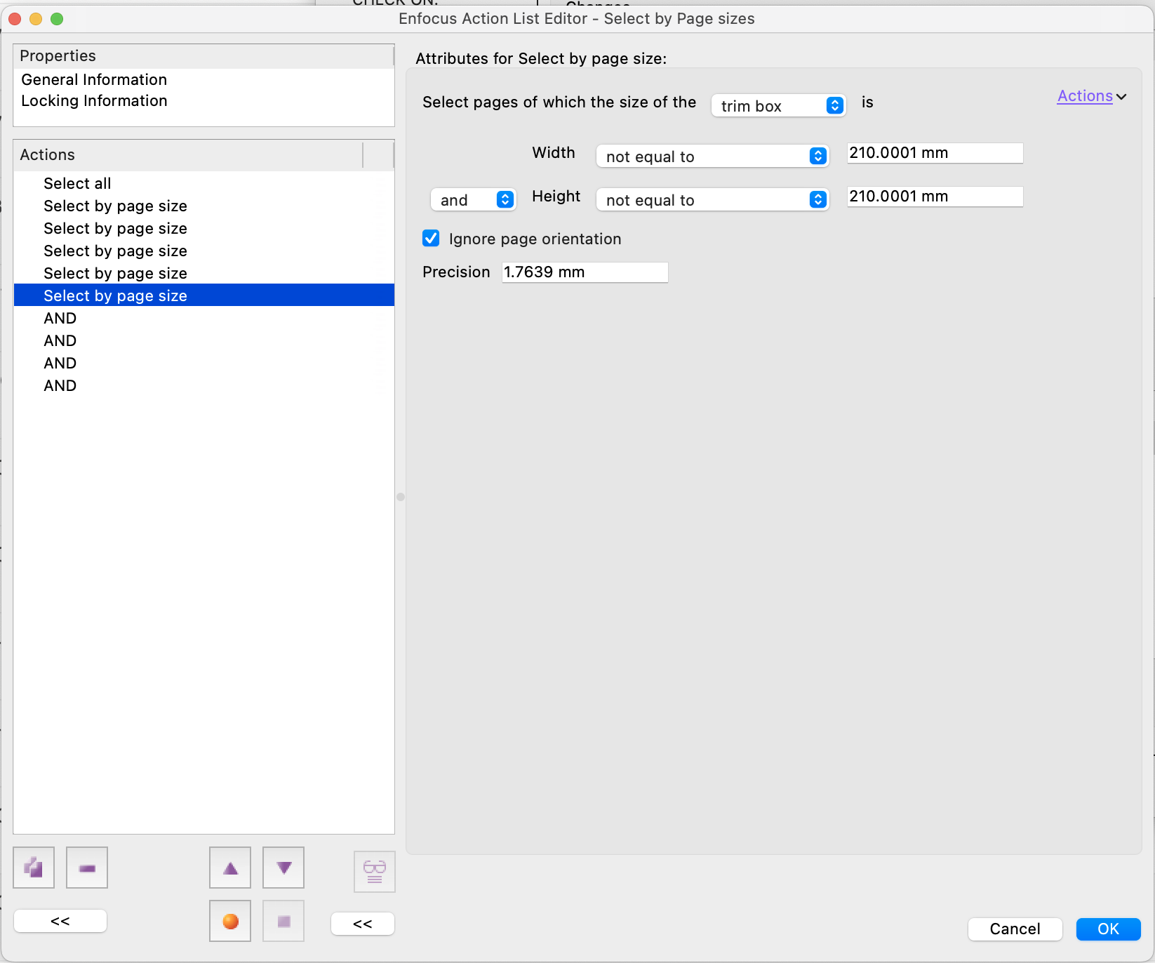

Hi, sorry for my lack of understanding, I have the sizes and the AND's in an action list... what am I missing to reject a size not specified in the select by page sizes?

Re: Variable page sizes accepted in preflight check (Boolean)
There is no "Log selection" at the end.
Post by DJS »
Thank you
