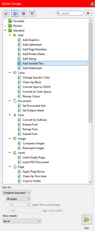

In Acrobat you choose 'Tools' -> PitStop Process -> Global Changes. Or in Acrobat press [Alt+Ctrl+G].
In the 'Global Changes'-GUI choose Standard -> Add -> Add variable Text.
