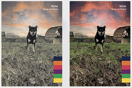

When using the convert colours actions the result is appearing washed out - any fixes?
Screenshot 2024-09-05 at 12.07.26.png (209.29 KiB) Viewed 12425 times
after action on left - pre action on right
Screenshot 2024-09-05 at 12.05.50.png (240 KiB) Viewed 12425 times

Color conversion in Pitstop relies on the Color Management settings specified in the Pitstop preferences. The way colors are converted will vary based on these settings.
To ensure consistent results, configure the Color Management settings to match your "house standard." Ideally, your RIPs and other systems should also adhere to similar color management and conversion settings.

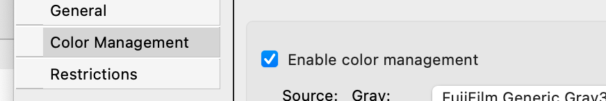

and, thank you for your advice, I had the colour management turned off (there was an issue with that and acrobat a long time ago and I never turned it back on)
Screenshot 2024-09-05 at 13.29.27.png (29.52 KiB) Viewed 12411 times
