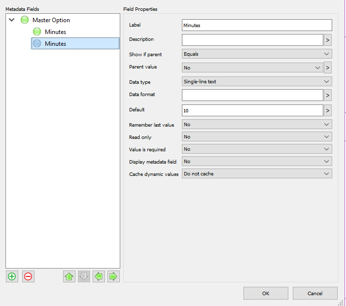

I think this is quite simple and even possible in the configuration of the submit-point ;)
Add a second child-field that is triggered by the "No" value of the parent.
Set the default value for this field.
Then set "Display metadata filed" to "No"
Now you will always have a field "Minutes"
Success

Thanks r.zegwaard! That indeed was simple but very clever :idea: ;) I didn't think of the idea with two different fields with the same name :roll:
