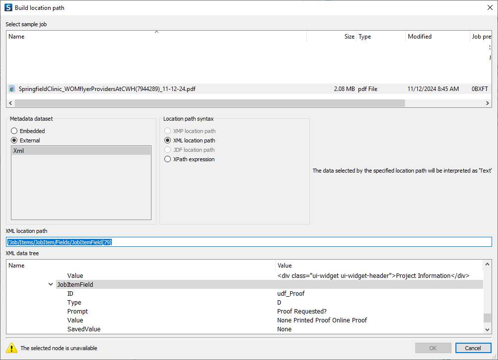

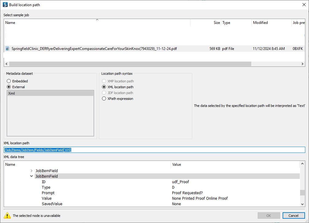

I have a web to print solution that provides me with an XML file with every job ticket. When the job tickets were created, some questions are universal across order forms, items such as "job name", "due date", "quantity", "is a proof required", etc. The problem is that they are not always in the same order on each form's XML file. In my example, I have an XML file for my posters order form and an XML file from my flyers order form. I'm looking for the saved value for udf_Proof:
<JobItemField>
<ID>udf_Proof</ID>
<Type>D</Type>
<Prompt>Proof Requested?</Prompt>
<Value>None Printed Proof Online Proof</Value>
SavedValue>Printed Proof</SavedValue>
In the order form for posters, the XML location path according to switch is:
/Job/Items/JobItem/Fields/JobItemField[79]
In the order for flyers, the XML location path accodring to switch is:
/Job/Items/JobItem/Fields/JobItemField[105]
In other order forms it's a different number. My question is, can you have switch look for the key word <ID>udf_Proof</ID> and identify the saved value, rather than just looking for the specific JobItemField[XX] ? I've attached a couple of screen shots showing the location path from switch as well as the XML files
XML Files.zip
(14.95 KiB) Downloaded 1010 times
Screenshot 7944289 (Flyer Order Form).jpg (133.89 KiB) Viewed 7096 times
Screenshot 7943029 (Poster Order Form).jpg (134.38 KiB) Viewed 7096 times
