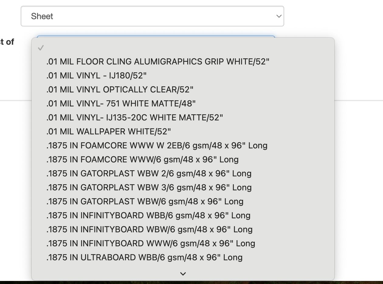

Using scripting in the submit/checkpoints we query our database for active job numbers, which is straightforward. However, I also handle something similar to what you're aiming to achieve. Since Switch can only query as the submit form is loaded, I managed this by using the parent to control the process. I then implemented a script to query each group within the parent. In my case, I select either "Sheet" or "Roll," and each selection triggers the query results displayed as a dropdown and the user can select what they want. I also have this to add or move stocks so the list is auto-maintained outside of the parent categories that are manually made it the submit point
Here is screenshot, There are some roll stocks in there but that's because those are mounted vinyl so they are used as a sheet.

@rhd-ole, so if I understand you correct the values in the parent field are predefined in the Submit Point and you then query the database for the values in the child-field based on the choice made in the parent field? That's interesting :idea:
Would you be willing to share the script that you are using?

Yes, that exactly correct. I have a script that queries each parent value in our DB (predefined values, and in my case never changed) so when ever the Parent value is selected it loads the query results as a list in the child-field.
I also do something similar for exact reprint jobs where the art is always the same. I wrote a script that reads the contents of a folder and displays as a drop down in the submit point. Using this method allows the submit point to be auto-managed, when new art is added to the repository of files, it'a automatically added to the list in the dropdown.
I'm PM you these scripts, The stock and job number ones are specific to our MIS though but should give you an idea, the other used for reprints. just relies on a defined path.
