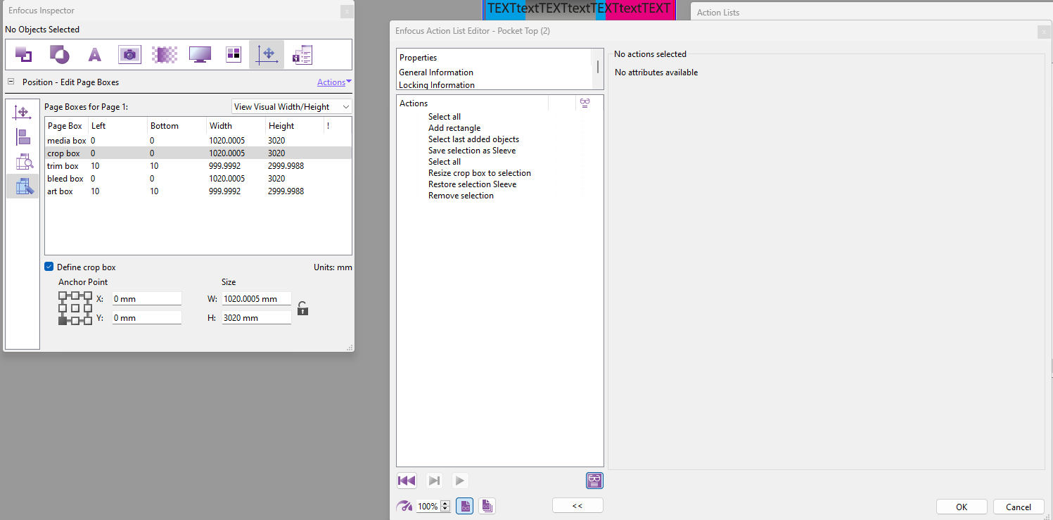

The cropbox has not changed but I suspect I need to change something in the settings. Please see screenshots.
Many Thanks

loicaigon
Posts: 782
Re: Amend Page Box to Adjust Height Only
Post by loicaigon »
My bad, please adjust as follows:
Select all
Add Object > Rectangle (width>trimbox and height>50mm)
Select last added object
Change crop box > adjust to selection
Remove selection
